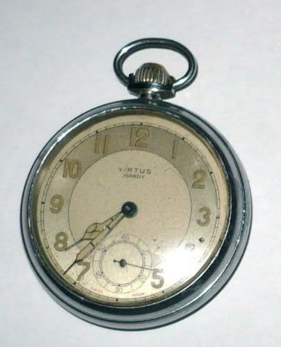

I picked this up today and thought of you merry gentlemen here. I was browsing the mixed and varied wares offered by the sundry townsfolk from the back of their horseless cariages when, perchance, I came across this timepiece. A quick exchange of coin resulted in my ownership of a "Virtus Hardy".
From a bit of quick sluething on the aetherweb I have deduced that "Virtus" was a lesser brand of the swiss manufacturer Oris, and the same watch face is used on atleast one of their "Oris" branded pocket watches. Today the company deals in exclusivity.
The hands are radium painted (as confirmed by a quick pass of the geiger counter - a must for the well prepared gentleman), leading me to assume a 1930's-50's date range. The case is snap-off, twist/hammer/utter expletive-on and the internal movement is unmarked except for a ".180" calibre stamp. The stem and crown are plated brass, the case steel and the frontispiece is mineral glass.
I've never dealt with pocket watches before* but hope to make it a part of my daily atire, particularly when undertaking geology fieldwork. I've given up on the wearing of a wristwatch when underground or clambering along coastline.
*Although, in my defence, I did make a mantleclock out of scrap wood, rosewood veneer and an old 8-day movement for my GCSE woodwork class. I have since re-homed a 1930's Napoleon Hat clock, so my room does resound to the pendulums beat.
