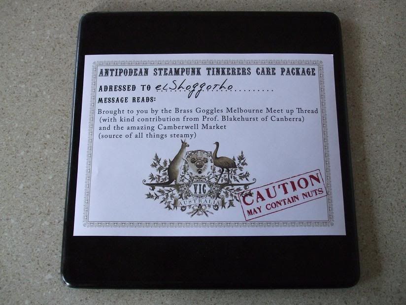

Here is the label in untouched form from the colour copier (baking tray used for contrast).

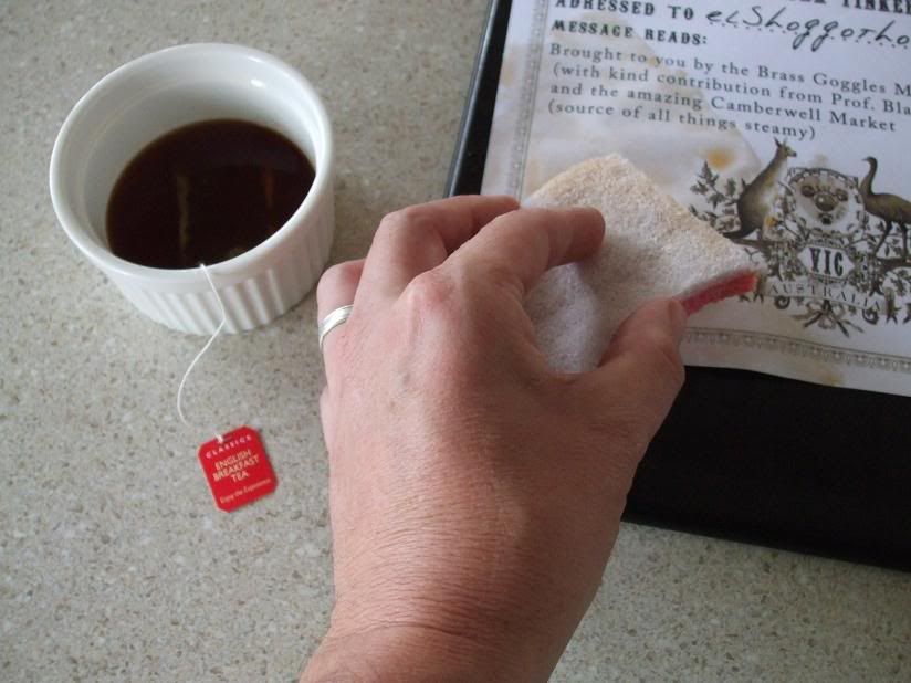

First thing I did was brew some tea - a nice strong English Breakfast brew (tea of choice). I then sponged the tea brew over the print, being careful not to drag in case the ink ran.
After sponging, I then used the scourer side ofthe sponge to drag away some of the wet paper edges and give the label the scuffed worn look.

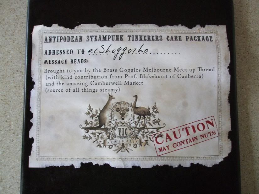

End result, a faded yellowing label with scuffed edges. I glued it to the old leather suitcase using spray adhesive, making sure to rub down the edges.
