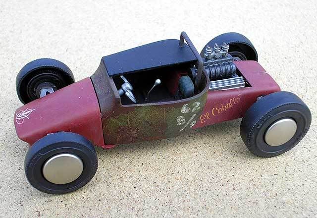

The Rustall system is all paint, in truth.  A pair of pre-diluted water-base washes, some sifted earth and a water-based dead-flat clear coat.  Experimenting with the order these product are applied can give some very convincing effects, and if you aren't pleased, a little ammonia-based cleaner (Windex, etc.) will remove it quite handily.
This one was done using lacquer bases with the rustall system over the top, though I was going more for an oxidized aluminum look, so I used very little of the "Rust" wash, and more of the "black" wash.
The rust on this one was applied before the "paint" coat - the rusty areas were masked with rubber cement and moistened table salt, then the ivory was sprayed over the top.  When it was dry, the "masked" areas were rubbed, exposing the "rust" underneath.
A similar method was used on the "bucket" section in the middle of this model - the car is only about 3-1/2" long.

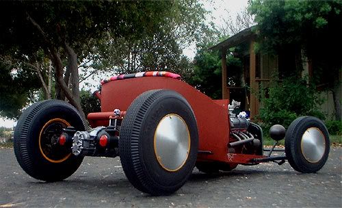

This is a 1/8 scale hotrod model I built a few years ago. The "rock chips" on the front suspension and the top of the radiator shell were done pretty much as I described previously - an oxidized patina was applied, and moistened salt was used to mask the "chips" before applying paint.  The skull and lug-wrench in the center of the radiator opening were painted flat black, and dry-brushed with different metallics before I gave them a light coating of the "Rust" wash.  The headlight buckets are really easy - to get a more uniform oxidized appearance, I grabbed two cans of hobby spray paint - Tamiya Light Gunmetal and Floquil Roof Brown - and alternated misting coats of each on the buckets until i got the look I was after.  This is a very simple and expedient way to get a realistically distressed appearance on "steel" pieces.  On areas that receive more wear, a brighter silver can be lightly drybrushed on the edges.

I have to chime in and say your car models are awesome, any larger pics of the 1/8 hotrod? thanks for th tips!

Here are some more shots - I don'y know if you can make out the coolant-soaked rag around the upper radiator hose, or the fact that I finished the six carburetors in three distinct levels of patina, but you should be able to get the gist of it.
