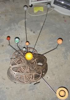

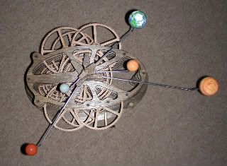

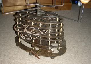

Now that my internet has finally come back on (thank you B.T., I love you...), here are, as promised, some pictures of the new one.
The big difference between this one and the last is that the Earth is now tilted, and continues to point in the same direction as it makes its way around the sun (that's what gives us the seasons, or so I'm told), and the Moon now rides on the disc below it giving it a 5 degree up and down motion as it orbits us - just like the real one. The big wooden disc under the Earth/Moon mechanism (you can see it best in the last photo) is a flywheel which keeps the movement of the mech nice and smooth. And the rocket? Well, that was added as an after thought, but looks brilliant in motion as it chases the Moon, just couldn't resist.
Hope you like it, all comments, good and bad, gratefully received.

It is still, and will always be, magnificent.   My excitement about this project must of made its way all the way to the North Pole, because apparently Santa got me a brand new dewalt scroll saw for Xmas.   Waiting anxiously for a chance to try her out...

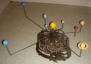

Hi folks,
Just thought that I'd add these pics here for you coggy fans that don't normally frequent the tactile side of the fence (where I've already posted them a week or two back) - so I apologise if these are not new to you!
The pics are of a machine I've just finished that's being used as part of limited release period horror film set in the 1930's. It's powered by a small geared electric motor that's hidden in the base, but the machine had to look like it was clockwork hence the winding 'key' that's attached to a sound effect ratchet that gives the expected clicking sound as it's wound - very satisfying!
Only 8 planets included as Pluto was yet to be discovered at the time the film is set.
This machine is sporting a full set of the fabled laser cut gears - and by god do they cut the build time down! The whole thing was completed start to finish in two weeks (and that was with going to work every day!). More time would have been nice to do a few more finishing off tasks, but on the whole it worked out just fine with all the gears working as they should straight off the drawing board.
Anyway, here are the pics. Hope you like it.

MM
That. Is. Stunning.
Any problems with the longer planetary arms torquing down on the post and binding (no counterweight)?

Thanks Mr. Designer,
Nope, I did worry myself as it was getting bigger, but it runs really well. The motor I used wasn't exactly what you'd call beefy, but it hardly slows at all when it's driving the mechanism. The laser cut gears make a difference too, much smoother and more accurate with no binding to sort out with a needle file! Bliss...
When it gets back from the States I'll get it filmed and post it on youtube with a link from here.
Next ones got Pluto on too, as well as the complex top mechanism - so the full monty - so we shall see what happens there... No electric motor though, so at least the drive mechanism is a known quantity.
